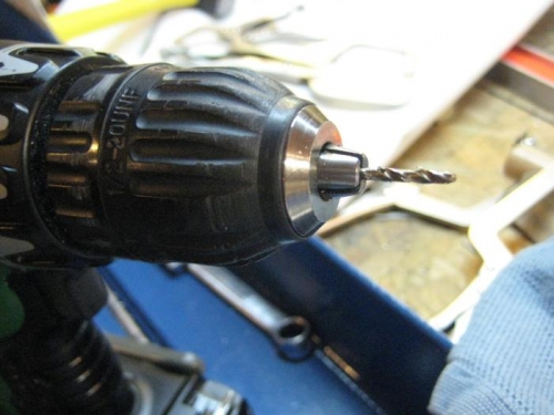

Another frustrating night of drilling stainless. Have I ever stated how much I hate drilling f*&#@ stainless?!!
I broke 4 bits in the span of 3 minutes!! But then light dawned on marble head...
I chucked one of the broken bits so that only about 3/4" was out of the chuck (photo #1). Now I could push hard like a madman, against the stainless and the bit wouldn't break! Between the drill bit and extreme pressure, each hole was nearly punched through instead of drilled. I had to press the back of the drill into my chest to push every bit of force I had in my body against the stainless, to get through. Two hours to make 11 holes!!
Broken bit, chucked.

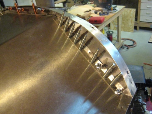

New holes cleco'd from the forward face of the firewall

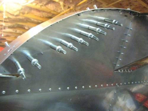

View from the rear
View from the rear
