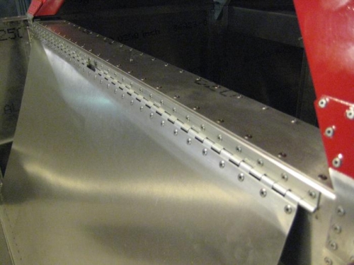

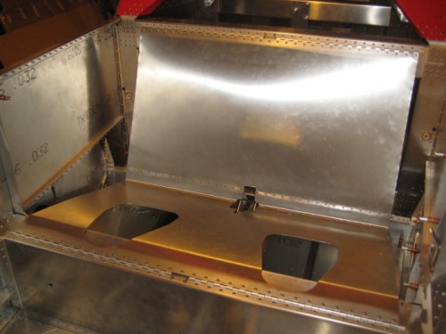

Finished the installation of the seat pan!
- Located and installed the second half of the hinge sets at the seat back, and at the spar tunnel.
- Had to make another hinge half and two hinge pins for the forward seat pan attachment. Somehow I had neglected to make those a couple of weeks ago.
- Since I'm doing the lowered seat mod, and that means the seat pan straddles a pushrod, there is a cover (photo #1) that attaches to the floor structure and extends up between the seats. With it in place I could not get the center (where you butt sits) hing pins in. The end of the cover got in the way. So in photo #1 you can see I notched out the back corner of the cover so the hinge pins will clear.

This piece covers a pushrod per the lowered seat mod (notch for hinge pins)
Seat pan installed!
Seat pan installed!
