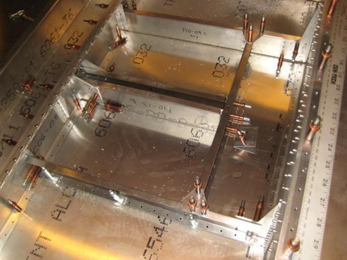

- Finished pilot drilling and then updrilling all the holes for all of the channels that make up this structure.
- Next will be to debur and finall get to some riveting! (Although the bottom/floor skin will remain cleco'd only, allowing access to the cockpit from below, all the way until the day before the aircraft gets its final inspection).

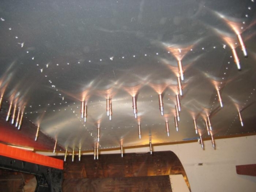

Nut plates installed for cover (cover at upper left)
All parts finally located and updrilled
All holes for floor structure done and updrilled
