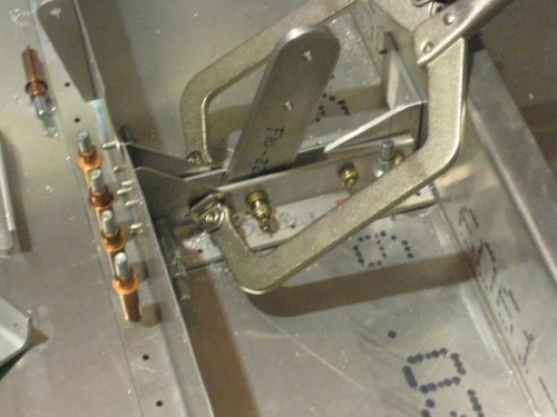

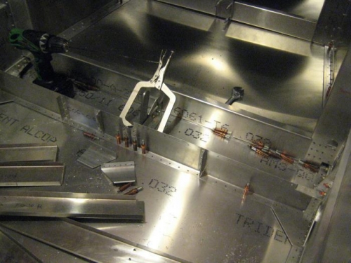

Forward fuselage floor structure
- Finished drilling then updrilling all the holes that join the C06-07 cap assembly to the C07-02 assembly.
- Finished drilling then updrilling the holes that hold C07-02 to the floor/skin.
- Drilled then updrilled the (2) horizontal gussets F10-24.
- Drilled most of the pilot holes to secure Idler assembly F10-16 to the various webs and floor/skin
Web of C07-02 with gussets F10-24, and Idler assembly F10-16
Horizontal gusset F10-24
