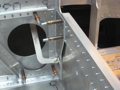

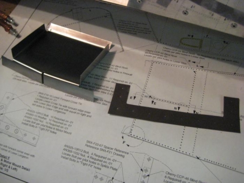

So I went on to make two more pieces of the upper firewall assembly (photo #1), and then test fit the rear spar carry through (photos #2 and #3). I'll drill these after I get the fuselage leveled back on the saw horses.
Two more stainless steel pieces of the upper firewall
Rear spar tunnel assembly clamped in place
Close-up of clamp through side of fuselage
