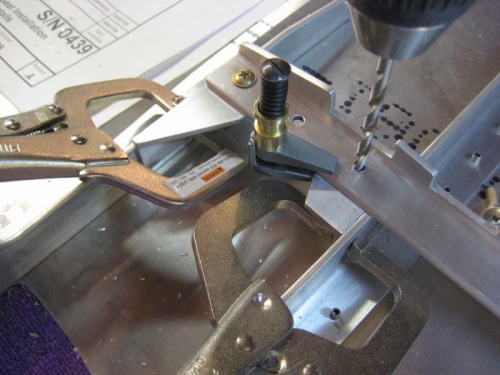

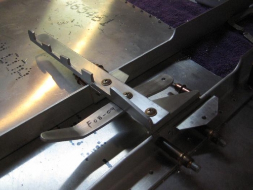

Finished the Trim/Flap assembly.
- Clamped all the pieces in place.
- Pilot drilled then updrilled. Used my 12" bits to get straight holes and to get to the holes under the detent angle (right side of photo #2).
- Deburred.
- Installed the plastic washers and screw to hold the trim lever in place
This sheet says to rivet in place (or at least it doesn't say "not" to). But if I do that then the rear angle will no longer be removealbe. It needs to be removeable for wing rigging. So I'll leave this assembly simply cleco'd for now.
Everything clamped in place, then it's time for the drillin'
I'm leaving it all cleco'd for now
From above
From above
