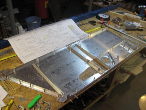

Brief Description:  RIGHT forward fuselage
Started actually laying out the pieces. This is one of the few sheets in the Sonex set where they give you all the steps, in order, written out at the right side of the plans. I got through step 12 tonight.

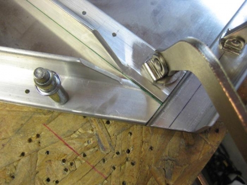

- Before placing any angles I first measured and drew all of the guide lines on the plans. I didn't want to have to take the thing apard each time I had to measure something.
- Then I followed the order of installation on the drawing sheet. I would clamp one end on a gude line, then hold the other end tightly down while I drilled a pilot hole far enough into my workbench top so that I could cleco directly into the wood top.
- Add at least one other deep hole at the other end of the angle, and cleco to the workbench.
- Drill the rest of the pilot holes in the angle.

Getting the first angles in place
Several angles meeting
More angles in place
