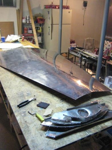

- Got an angle drill attachment for my Dremel tool today, so drilled the final 8 holes in the two clips at each end of the turtle deck splice channel. Getting inside the back of the tailcone to get those last 4 holes was THE most difficult spot I've ever had to get to while building this Sonex!
- Deburred the outside face of the turtle deck skin and the upper row of holes in the side skins, while in place.
- Then removed all the clecos and removed the turtle deck back to my work bench.
- Did the same for the formers and all the other little pieces that make up the tailcone.
- Began deburring. I would estimate I got 70% of it done tonight.

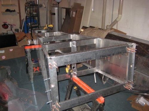

Lots of pieces to debur
Turtle deck removed so everything can be debured
