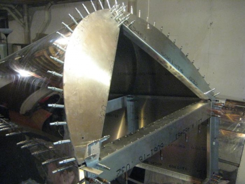

#1 turtle deck formers
- Locates and pilot drilled the #1 formers and the splice plate at the top.
- Located and pilot drilled the lower splice plates (left and right) that join the #1 formers to the box cross tie
- Then updrilled all the holes to size for rivets
#1 formers, and top-center splice plate, pilot drilled in place
Lower splice plates pilot drilled
