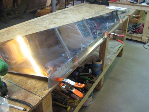

- Laid out, drilled, deburred and installed the 6 (3 on each side) brackets onto the splice channel.
- Put the right skin on top of the channel, aligned with the edge of the channel per the plans, and clamped in several places down the spine.
- Drilled about 15 to 20 pilot holes down the length of the skin/channel, making sure to always align the skin with the edge of the channel flange before drilling. If your channel had a bow in it, that now comes out as you align the skin with the channel flange.
- Put the left skin on top of the right, and cleco'd thru both skins and into the pilot holes.
- Then went back and drilled the remainder of the pilot holes thru all 3 pieces.
- Took everything apart and deburred.
- Put it all back together and riveted in place.
- Laid the entire assembly on top of the tailcone box, but without a second set of hands I did not want to try to put it in place.

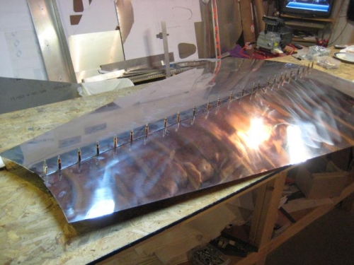

Clip angles have been riveted onto the channel, along with pilot holes into the channel.

Updrilled, and just prior to riveting.

Layed on top of the tailcone box, ready to be test fit.
