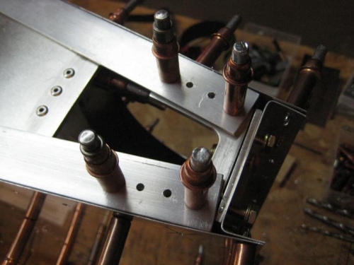

29. Updrill the 8 holes thru the upper longerons and into angle T12-05 (photo #1).

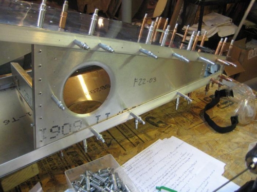

30. To drill the shear web F22-03 into the longerons and angle F22-06, either turn the fuselage upside down, or on its side (per the photos below, I did it on its side). Remove enough of the lower skin so you can get inside to drill into the shear web.

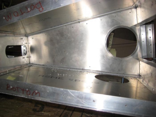

31. From inside the fuselage, use the holes in the F22-03 shear web to drill pilot holes into the upper longerons. Then updrill to size for rivets (photo #3).
32. Do the same for updriling into angle F22-06.
33. Now take everything apart and DEBUR!
8 holes in longerons, into angle T12-05.
Fuselage on its side to access the shear web from underneath.
The shear web viewed from underneath.
