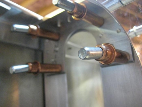

8 Aft tailcone assembly
18. Mark the centerlines down the flanges of Bulkhead F23-02 (do it now, before you assemble everything).
19. Put the F23-02 bulkhead and angle F23-03 back in place with clecos (photo #3).
20. Put the Shear Web F22-03 in place and cleco to bulkhead F23-02 (photo #2).
21. Cleco angle F22-06 in place under the shear web (photo #1).
22. Updrill thru the fuselage bottom skin, lower longerons, and angle F23-03 (drill for AN525 bolts) -- (photo #3).
23. Updrill thru the fuselage bottom skin, lower longerons, and angle F23-04 (for rivets).
24. Updrill thru angle F22-06, and thru the face of bulkheads F27-05 (photo #1).
Angle F22-06 with Shear Web F22-03 above. Angle against bulkheads F27-05.
Shear web angle cleco'd to bulkhead F23-02.
Angle F23-03 cleco'd in place. Holes at longerons will be for bolts.
