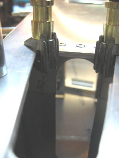

16a. Place the Shear Web F22-03 in the upper fuselage, under the longerons. Make sure angle F22-05 (which is already riveted onto the shear web) is on the AFT side of the Bulkhead F23-02 (photo #1). Clamp the shear web assembly to the upper longerons (also photo #1 + photo #2).
16b. Adjust bulkhead F23-02 if it needs to be tweaked in place.

View from inside: shot from the aft TOWARD the front of the aircraft. F22-05 is part of the shear web.
