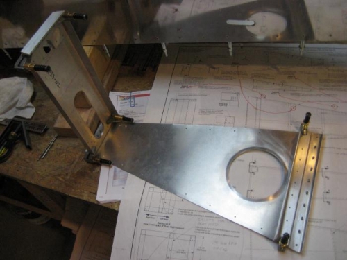

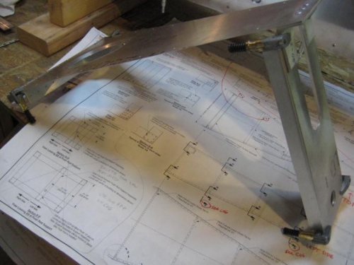

Again I spent a LOT of time looking at others' web sites and scratching my head. As great as some of those sources were they still lacked the step-by-step description of what order all the work was done in, and how they got into those tight quarters. I'm going to describe in detail how I did it. My way was a little different than some of the other builders' web sites, but this is what worked for me. Since Kitlog is limited to 3 photos per page, this will take several pages to describe.
1a. Clamp all parts together outside of the fuselage to see how they will fit together (photos #1 and #2).
1b.Locate angle F23-04 and tailwheel/skid mount F23-01 in the bottom of the tailcone to see how they fit, too (photo #3).
Many of the tailcone parts clamped together to understand what goes where.
From the underside
From the underside
