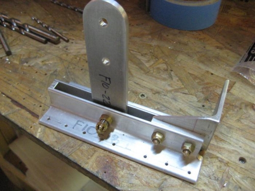

Finished the F10-17 assembly:
- drilled for the two bolts holding the assembly together
- Cut to size, the steel spacers needed to go into the bronze bushings. See the log for "Wings 05-01-2010" for how I resized the inside and outside diameters of the steel spacers.
- The moving part was binding pretty badly when everything was tightened to specs. It would only let up if I completely loosened the two bolts holding the assembly together. So I added a spacer, visible at the far left of the assembly in the photo below. That kept the part from binding. I make the spacer thin enough that it won't interfere with the rivets that will be installed later when some mounting brackets are fastened to it.
Done
