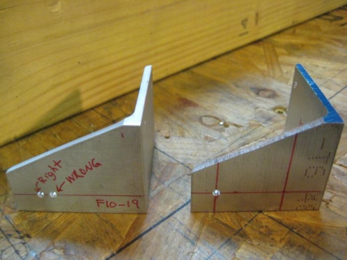

- I measured once and drilled once on F10-19 (photo 1). Mistake. Should have measured twice and drilled once.
- So I remade the part.

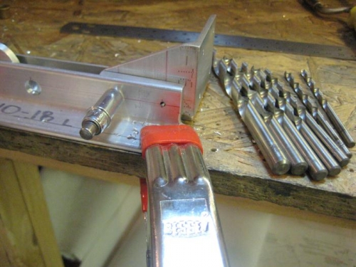

- Drilled just one of the two holes in F10-19 and put a cleco through it. Squared up that part with the workbench and drilled the second hole (far right hole in photo 2).
- Set the F10-19 angle + spacer between the two F10-18 angles, then drilled through the spacer.
- Drilled the large pivot hole (far left in photo 2). It needs to be 7/16", so I drilled to 3/8" using all those bits in photo 2. Then I used a hand reamer to ream the holes for a tight fit 7/16".

I used all those bits to make the large hole to the left, then reamed to the final diameter.
