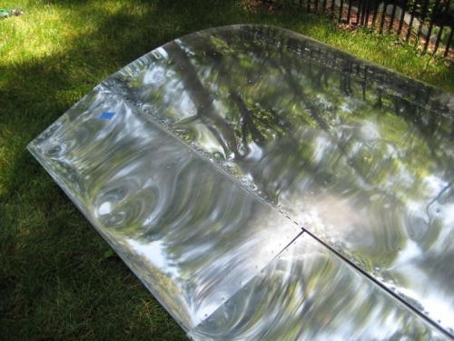

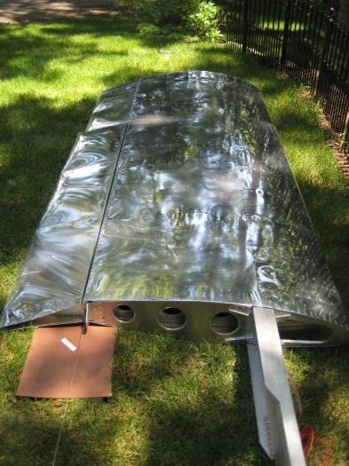

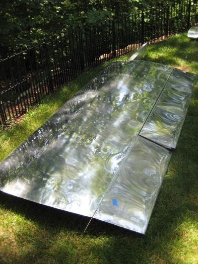

Left wing surfaces on
Left wing close-up
Left wing close-up
Left wing again
Left wing again
