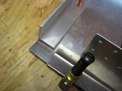

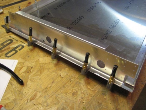

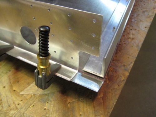

Finished bending, cutting, drilling, filing and sanding F27-01 R. All of that took about an hour.
Then laid out, clamped, pilot drilled & cleco'd F27-01.
Did the same for F27-02, -03, -04 and -05.
After I installed all the channels I sighted down the cable holes and noticed that F27-02 didn't align. When I investigated I found that the part was labeled as F27-02 R, but it was actually the LEFT channel! That meant I had to pull it off and discard it (there is no chance of the holes aligning with the left fuselage skin.
So I found F27-02 L, and relabeled it as "R" (since that's what it actually was), and installed that.
The old adage about "measuring twice" seems to go for "LABELING" as well! I'm going to have to be more careful about checking parts before I install them.

F27-01 ready for pilot drilling
F27-01 at the top edge.
F27-01 at the bottom edge.
