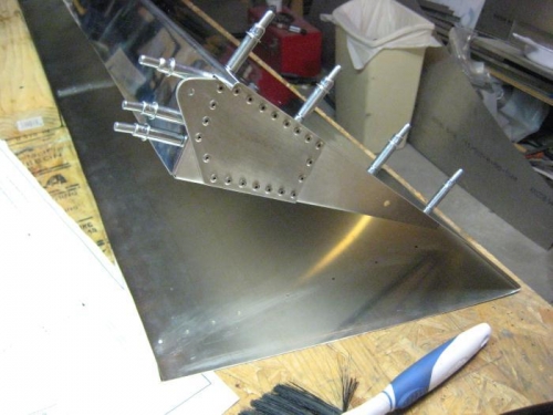

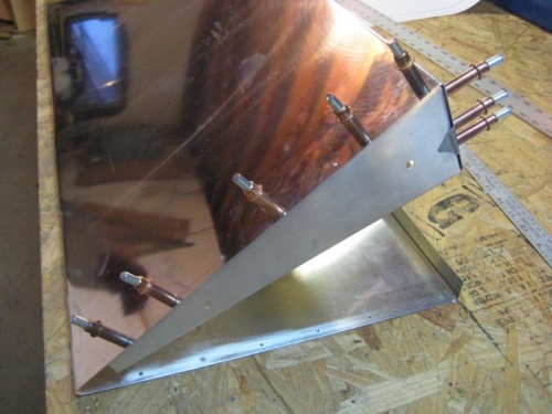

RIGHT flap construction
- Laid out for all the holes in the skins.
- Cut the notches out of the inboard end. As with the ailerons I used a Dremel tool to cut at the bends, then the shears to cut everything else.

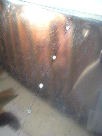

- Pilot drilled all the holes in the skin.
- Drew centering lines on all the rib flanges then aligned and pilot drilled 2 of the 4 ribs.
Typical pilot holes
Outboard rib
Inboard rib w/ control attache plate.
