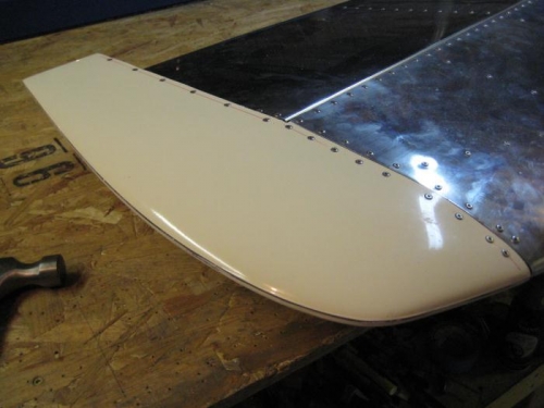

RIGHT horiz tail tip installation
- Layed out and drilled the pilot holes in the RIGHT tail tip
- Duct taped the tip in place and pilot drilled into the ribs
- Updrilled, deburred and riveted the tip in place
The RIGHT tail tip finished
Truly finished horiz stab
