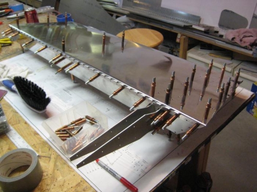

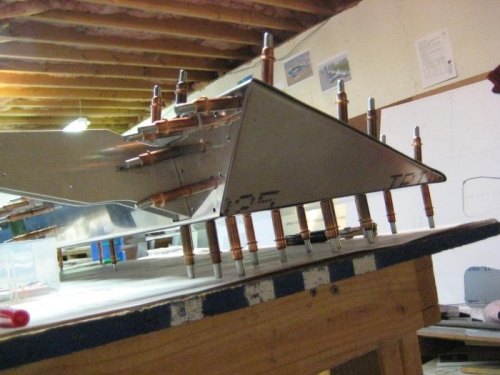

LEFT aileron construction
- Finished pilot drilling through the hinge, into the aileron
- Updrilled all the hinge holes
- Took it all apart and deburred everything.
- Put it all back together and cleco'd, ready for riveting tomorrow
Aileron: deburred and ready for riveting
Outboard end
