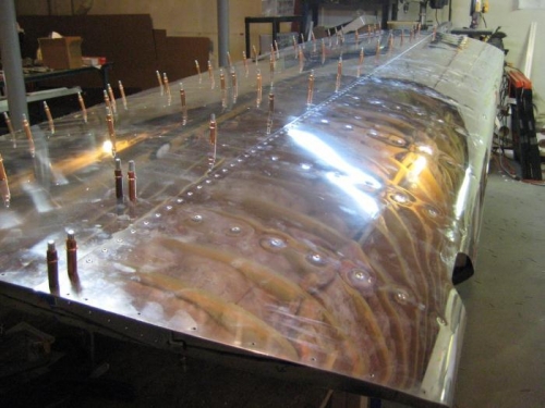

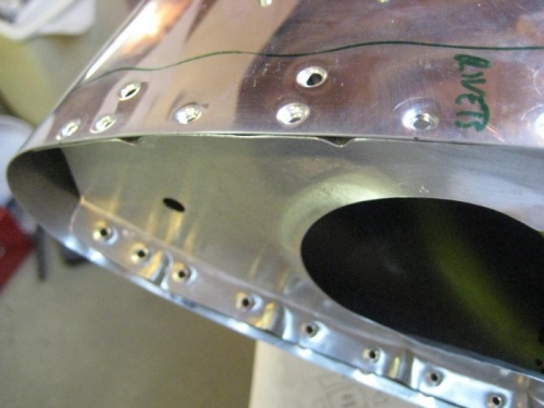

RIGHT wing root doubler + riveting
- Finished dimpling and updrilling the root doubler and the associated wing skins/ribs.
- Riveted along the entire length of the top spar cap.
- Installed all flush rivets in the top surface of the leading edge skin, and about a dozen standard rivets at the upper aft skin.
Dimpled areas at root.
Length of spar + top surface of leading edge skin with all flush rivets installed.

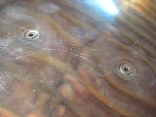

Typical flush rivets.
