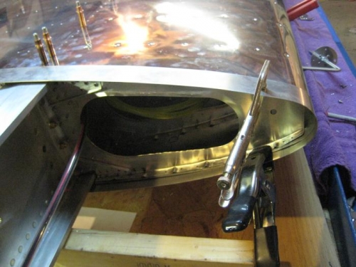

- Clamped the root doubler in place to get the bend at the leading edge. Next I need to locate the holes.

Root doubler in place to get the bend correct.
Another view of the root doubler.
