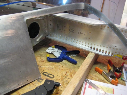

LEFT wing walk & root doubler
- In photo #1 you can see the doubler trapped between the skin and the rib.

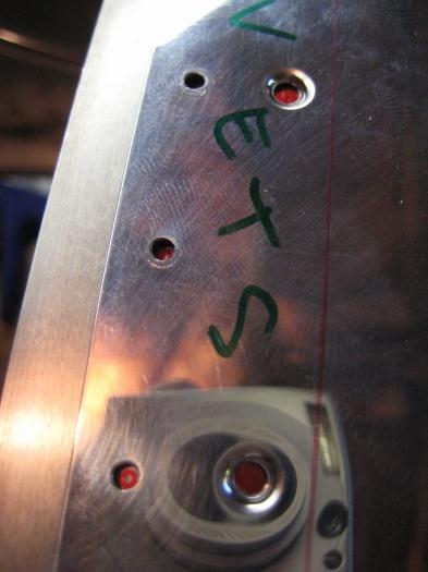

- In photo #2 you can see how I traced every hole from the skings to the doubler.
- I then removed the wing walk/doubler and pilot drilled all the holes I marked in red.
- Photo #3 is the result, with all pilot holes drilled.
The root doubler captured between the leading edge skin and rib.
I traced all the wing skin holes onto the root doubler underneath.
The wing walk/doubler on its side, with the leading edge bend & all pilot holes drilled.
