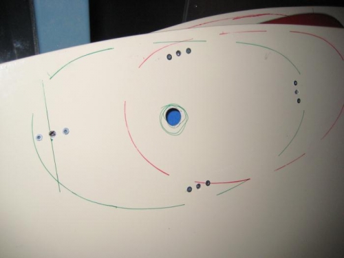

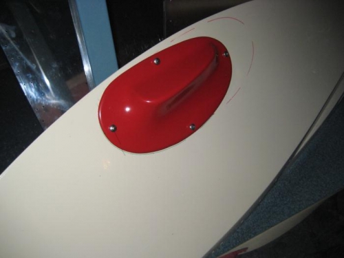

- With the pod taped down, drilled 4 holes thru pod and into wingtip

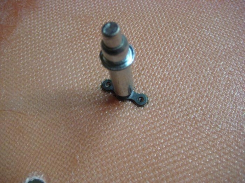

- Installed 4 nut plates. I was brain-dead when I intsalled the forward one (photo #2), orienting it horizontally instead of vertically. Fortunately the pod (green line) covered the forward rivet, but it was close.
- The hole in the wing tip is for the light's wiring

Screwed in place (10-32 x 3/4
Screwed in place (10-32 x 3/4" stainless steel screws)
