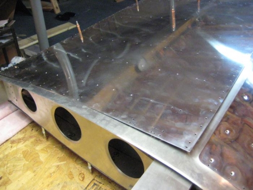

Worked on the wing walk. Did some head scratching for a good 15 minutes to figure out how to locate the holes.
1. Pull out the clecos at the upper aft skin where the wing walk goes. Also pull out all the clecos down the entire wing spar, so the aft skin can be lapped OVER the leading edge skin. That way the long root doubler that goes around the leading edge can be laid loosely over the leading edge skin (see photo #2).
2. Align the forward and aft edges of the wing walk and clamp/hold in place.

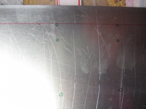

3. Use a thin tip Sharpie to trace around the insides of the aft wing skin holes, thereby transferring their locations to the wing walk (photo #3).

4. Remove the wing walk
5. Carefully pilot drill then up-drill the holes in the wing walk, using the sharpie marks to locate and center the holes.
6. Place the wing walk on the wing and cleco into place to check the alignment.
7. Success! Everything clecos in place!

Wing walk placed under aft upper wing skin

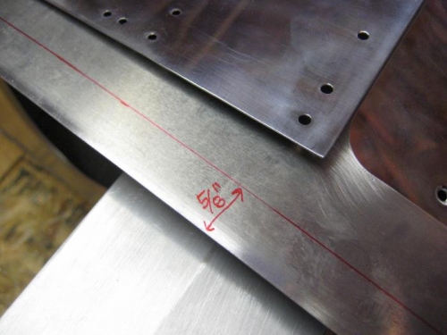

Instructions say to leave 5/8
Instructions say to leave 5/8" from the edge of the skin
Locations of wing skin holes transferred to wing walk.
