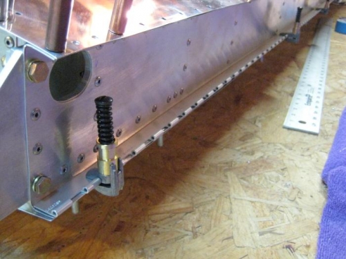

Flap Hinge - RIGHT wing
Cut and located the hinge half for the flap. As I've done in the past, I used small pieces of double-sided carpet tape to hold the hinge in place.
It's very important to get it straight, so after attching with the tape I checked it with a long straight edge and tweaked as necessary.
Then I used cleco clamps to hold everything firmly. Tomorrow I'll flip the wing to locate the aileron hinge, and to drill into the flap hinge.
