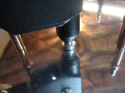

With the wing flipped over, next I up-drilled all the leading edge skin holes to a #35 (to fit the nail for the simple dimple die).

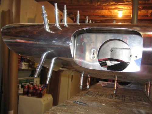

Then I began dimpling. All of the rivet holes that are accessible by hand through the wing ribs, can have the skin and rib dimpled together at the same time (pictures below). That was 4 ribs at the root end, adn 3 at the tip end (though the 3rd at the tip end was an excercise in contorsion).
After dimpling, all the dimpled holes were updrilled to the final rivet size. In test fitting the rivets, they fit very snugly, so I don't see any point to "reaming" the holes to size. The drill seems to work just fine. But I would suggest that after dimpling the skin and ribs separately, cleco it all back together before updrilling the holes. That way they will be aligned and the updrilled hole will be perfect through both pieces.

One more photo of the completed landing light cutout.
Using the Sonex
Using the Sonex "simple dimple die"
Holes that are accessible thru the ribs can dimple both skin and rib together.
