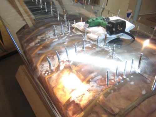

Brief Description:  Install RIGHT leading edge skin
After securing the leading edge skin down the length of the spar with clecos, I started securing to the ribs, starting at the center rib. I worked toward the nose, then moved over to either side of that rib line, to work on the other ribs (see photo #1).
Starting the dirlling and cleco'ing from the center of the wing, and moving out.

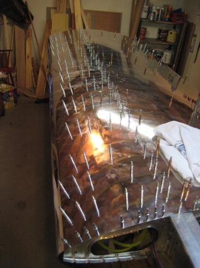

Tonight's work. A half dozen of the forward most holes need to be done.
