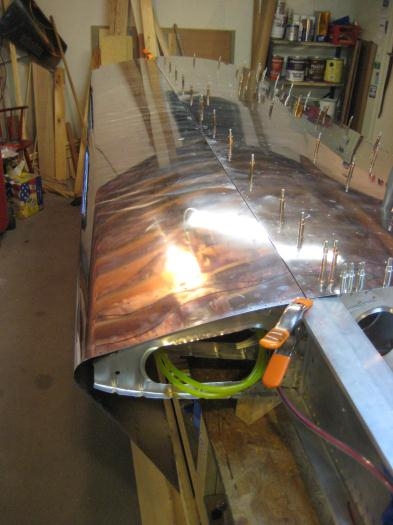

Brief Description:  Install RIGHT leading edge skin
Finally I can start installing the leading edge skins!

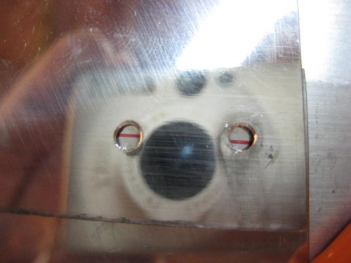

Drew a 3/8" line off the back edge of the leading edge skin, and another one 3/8" off of that. In photo #2 the red line (3/8" off the back edge) of the leading edge skin shows thru the holes in the aft skin, to show alignment for the leading edge skin. The second line is not visible, but it corresponds to the edge of the aft skin that you see in photo #2, as another source of alignment.
Leading edge skin clamped in place.
Leading edge skin UNDER, w/ guidelines at 3/8
Leading edge skin UNDER, w/ guidelines at 3/8" from back edge (showing thru aft skin holes)
Clamped in place...
