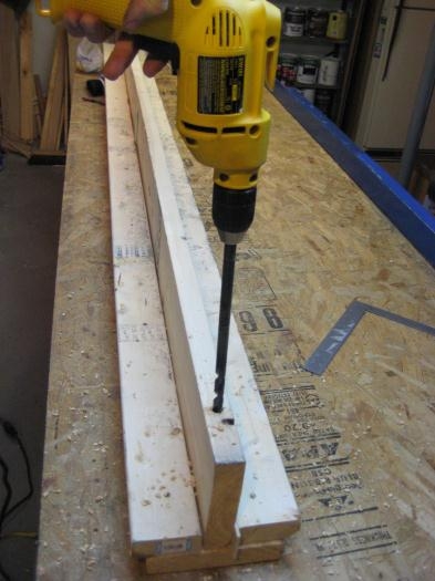

The instructions for the brake said NOT to attach it to your work bench because it would bend the bench. With some underneath reinforcement I was willing to give it a try (to save you the suspense, it worked). I put the brake close to the 2x4 at the edge of the bench (stiffer there), and added 2x4's at each end of the bench (photo #2), screwing them into the existing 2x4 supports.
I then use a 1/2" dia long drill bit (which I already owned) to drill through the 2x8 (on edge; photo #1), using a metal square to keep the pieces vertical. In photo #3 you can see the wood spacers I used to keep the 2x8 centered in the slot. I drilled all the way through the 2x8, the flat 2x10 base, the bench top, and the added 2x4 underneath. I did this at both ends, making sure they were located outside the length of the leading edge skin.
I then put a threaded rod (3/8" dia) through the holes, and put a washer and 2 nuts (2nd one acts as a lock nut) on the rod underneath the table (photo #2). Now I put a washer and nut on the top end of the rods (photo #3). The rods were 18" long, but in photo #3 it looks shorter just because the rod was hanging below the table.
Drilling through the brake with a long 1/2
Drilling through the brake with a long 1/2" drill bit.

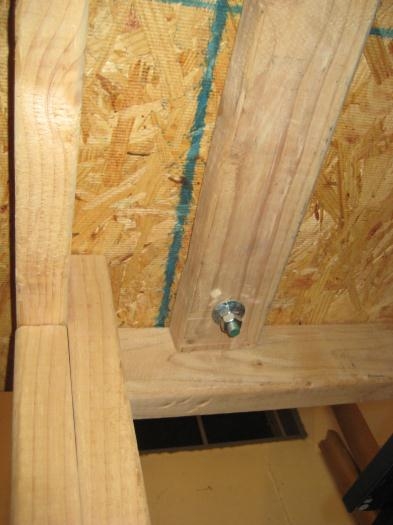

The hole and rod coming through the bottom of the table and the added 2x4.
