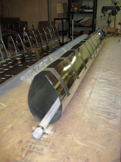

LEFT Wing - Vacuum bend forward skin
More pics...
Bent as far as I want to go with the tape.

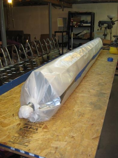

Plastic wrapped over and around skin, and then taped closed.

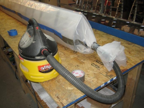

My wimpy shop vac wasn't enough, so I went and go the home vacuum.
