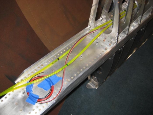

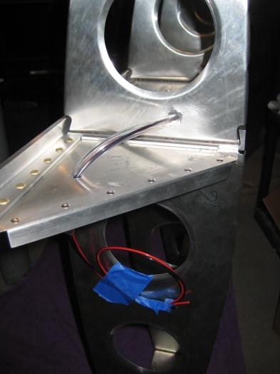

1) I finished pulling through all of the vinyl tubing I had run through the wings to run my lighting wiring in. Then I tried to snake the 14ga wire through. I could get just about half way then it would hang up. So I decided to NOT make the vinyl tubing continuous, and instead cut out most of the material between each rib. That left a 3 inch section of tubing running through each rib, through which I pulled the wires.
2) Ran the tubing for the pitot and static ports.

Tubing and wiring, with lots of extra. Note the color coding & text for the pitot/static tubes.
Static and pitot tubing, with wiring in vinyl tubing underneath.
At the wing tip, the vinyl tubing with the wiring inside. Again, lots of extra wire.
