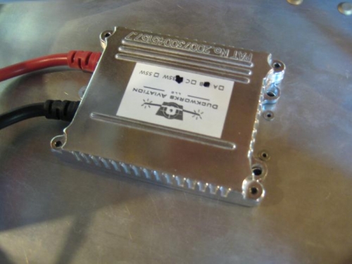

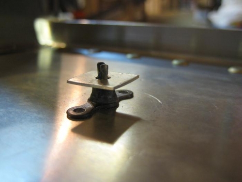

Added anchor nuts behind the 3 holes used to secure the transformer for the Duck Works HID landing light.
Anchor nut held in place with cleco (from below) and pc of alum w/ hole.
3 anchor nuts in place in the web of the wing spar.
And here is the transformer positioned over the 3 holes.
