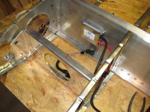

Worked on the Duckworks landing light. I'm puting it in the right wing because I think the wiring will be easier (I won't have to work around the throttle, flap handle and brake handle).

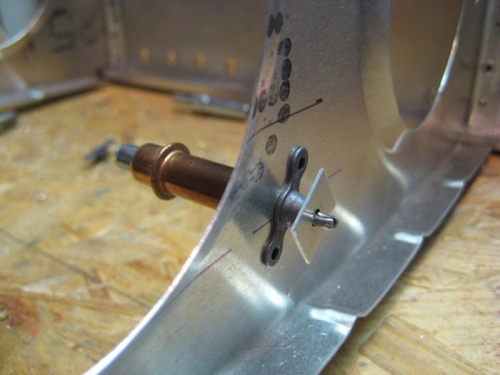

When puting in the nut plates I drilled the center hole first, but needed to hold the nut plate in place with a cleco. Since the nut plat hole is larger than the cleco and the pilot hole, I drilled a 1/8" hole in a little piece of scrap aluminum (photo #1) to allow the cleco to hold, and pull the nut plate against the rib.

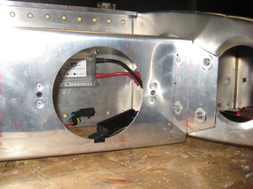

I did not drill the final 4 holes (for rivets) in the adjustable mounting bracket (right side of photo #3), because the final spacing of the ribs will be dictated by the leading edge skins. After the skins are cleco'd in place, then I'll do those final 4 holes.
Nut plate with cleco. Needed a scrap piece of alum w/ 18/
Nut plate with cleco. Needed a scrap piece of alum w/ 18/" hole for the cleco to grab.
The Duckworks light bracket mostly in place. The box in back is the transformer for the HID light.
The round hole where the HID light goes.
