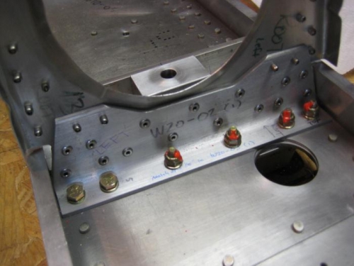

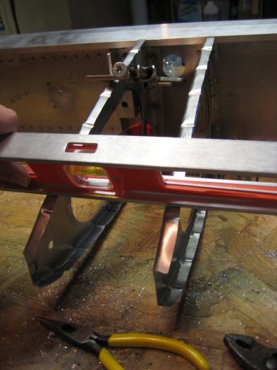

- Laid out the forward root rib, aligning it with the adjacent ribs (photo #1).
- Riveted the forward root rib to the attach angle (photo #2)
- Riveted the aft root rib to the attach angle
- Riveted the forward and aft Ribs #1 (photo #3).
Aligning forward root rib with adjacent ribs, and clamping in place.
Forward root rib riveted. I had to remove 3 of the bolts to access 3 of the rivets for pulling.
Aft root rib and #1 rib riveted in place.
