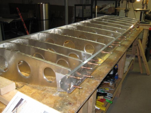

- Pilot drilled all the ribs at the interface with the rear spar.
- Then updrilled and cleco'd.
- Leveled the wing in preparation for installing the root ribs.

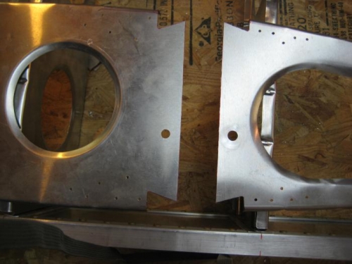

- Modified the root ribs per the plans (deburring and adding gussets will be tomorrow).
Rear spar updrilled and cleco'd in place.
Leveling the wing in prep for installing the root ribs.
Modifying the two root ribs per the plans.
