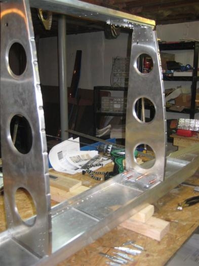

Brief Description:  Right Wing - Aft root rib - more pics
To get access to the root rib bracket for drilling I had to remove the #1, and later the #2 rib to do so. In photo #1 I have the wing standing, but the whole process was done horizontal. This photo was taken after the root rib was updrilled and cleco'd in place.

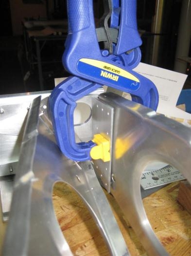

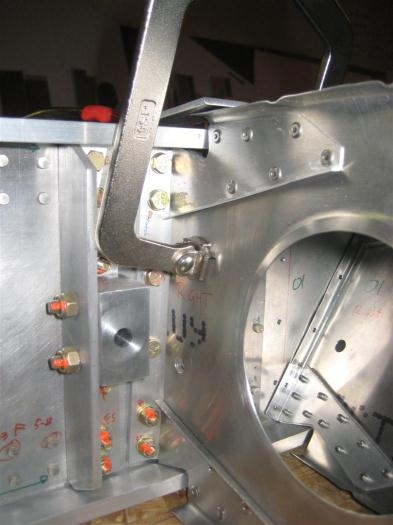

Photo #2 shows the forward end of the root rib clamped to the spar support angle. Photo #3 is the rear of the root rib at the rear spar.

Ribs #1 and #2 removed to allow drill access to the root rib.
The root rib clamped in place. The piece of metal above the top of the rib is for alignment.
The rear of the root rib clamped to the angle bracket on the rear spar.
