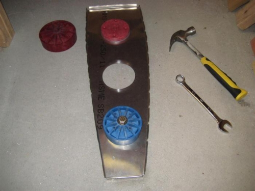

Main ribs
- Finished making the last 8 main ribs in the bending blocks.
- Began adding the lightenging hole flanges and fluting until the ribs are flat. Finished 10 ribs.
Using the flanging blocks. Screw down part way, then just whack it a few times around the perimeter.
Done on the far left. Almost done on the right.
