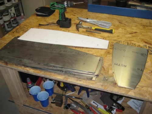

Cut rib blanks and drilled for template/jig
Cut out the remainder of the 20 main rib blanks from this .025 sheet, then drilled the two alignment holes in each, so they can be stacked between the rib template/jig.
A stack of 20 main rib blanks.
