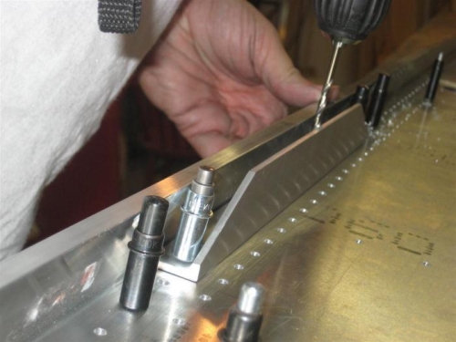

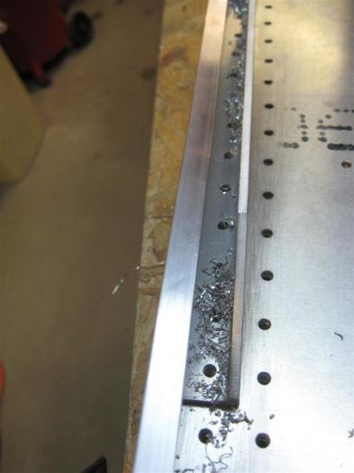

Finished deburring; drilled W11-08
Finished deburring the web and cap pieces.
Aligned W11-08 and held it in place with double-sided carpet tape. First drilled 3/32" pilot holes, then updrilled to final size. Still need to deburr all the affected pieces.
Drilling W11-11
Drilling W11-11
W11-11 up-drilled
