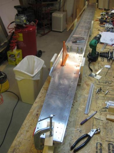

Brief Description:  Drilled nearly every pilot hole in spar/caps
Drilled nearly all the remaining pilot holes through the webs and through the top and bottom spar caps, as well as most of the angles. I find drilling 3/32" pilot holes first makes for more accurate up-sized holes, and the up-sized holes drill through like butter.
Damn, there are a lot of holes! My right arm and shoulder can tell you that.
With this work I topped 700 hours (702.75, actually) on the project.

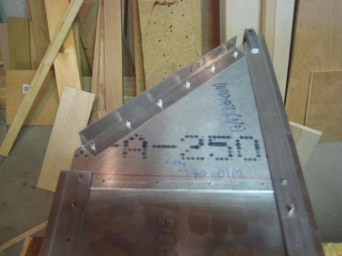

All angles set in place (you only see one on this face; others are on other face)

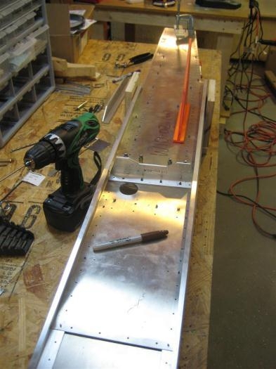

There are a LOT of holes in these things!
