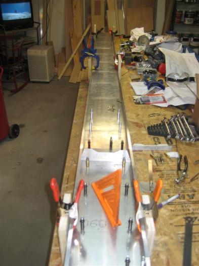

Brief Description:  Drilling thru left wing spar caps
Drilled a couple of dozen holes along the length of the spar, through the spar caps. With clecos in place the spar caps are now properly spaced down the whole spar, and held from moving.
Spacing jigs with clamps holding spar caps against them, to maintain spacing.
Another view. Square used to eyeball drilling vertical.
Looking down the spar with the 3 spacing jigs in use.
