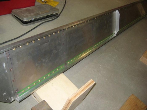

Brief Description:  More spar riveting

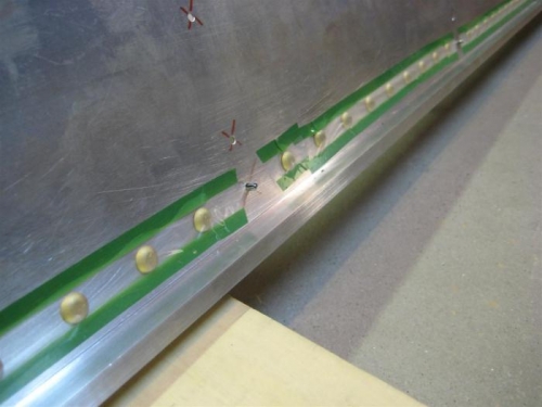

I drove over 120 rivets tonight. Prior nights I had put in 10 or 20 rivets at a time and then added the rivet tape. All of that necessitated turning over the spar several times.
Tonight I got smart and set up all the rest of the top spar rivets and added the rivet tape. When I was done with those I set up ALL the rivets along the bottom spar at once. Doing so allowed me to set over 100 rivets in fairly short order.
A reminder that I'm currently only driving the standard rivets, and not the flush rivets. Those are next.
I then set the bolts for the wing tie down and torqued them.
Lastly I set up the next 16 standard rivets. Tomorrow I'll set up and drive the flush rivets.
688 total hours on the project so far.
Rivet tape makes the work much easier
Rivet tape
Rivet tape
