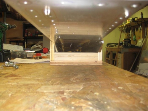

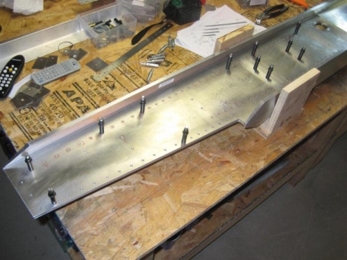

Brief Description:  Trying out new spar spacing jig
Finished countersinking for the flush screws (requires deeper countersinks than the flush rivets).
Then I cleco'd the right spar together and added the spar caps. Placed it all in the spar cap spacing jig I made, and it seems to be working as intended. I was going to make a couple of more jigs just to support the spar, but I think I'd rather build at least 2 more jigs exactly the same as this one (with the exact spar spacing).
The jig holds the assembly at the exact spar spacing
The jig from underneath
