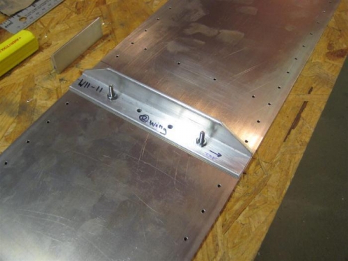

Continued on the right wing spar. I laid out and updrilled the holes for the W11-11 angle that the wing tie-down attaches to. It's held in place temporarily with some non-aircraft bolts.

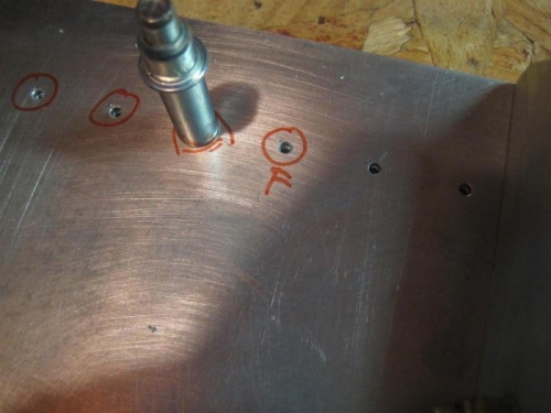

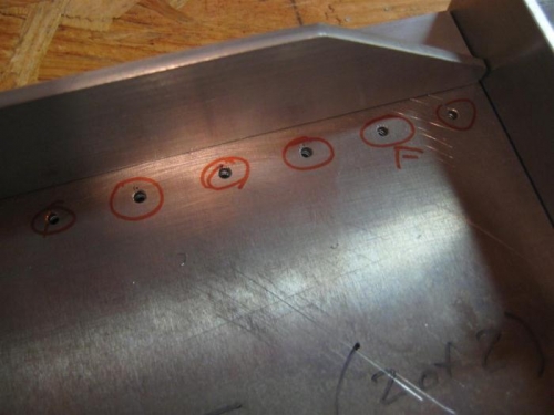

I put everything back together with temporary bolts and clecos. Next I need to updrill the rest of the holes, then countersink and dimple per the plans. In the photos below you can see I started to mark up all the holes that need to be countersunk ("F" for flush).

W11-11 wing tie-down angle
Marking holes to have flush fasteners
I'm using ORANGE for flush. I'll use other colors for other notes.
