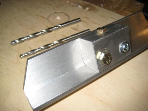

Brief Description:  Finished the wing attach blocks W11-02/-06

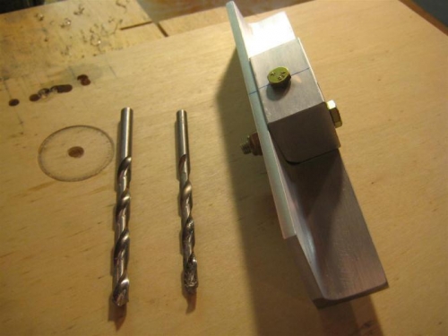

I had made these parts some time ago, but since I didn't have the AN nut/bolt hardware, I waited to updrill the two bolt holes.
I had 3 temporary bolts in each part. To up-drill I removed one of the horizontal bolts, updrilled with a 7/32" bit, then the final 1/4" bit. I used a little cutting fluit and the cutting went very easily. Then I put a 1/4" bolt in the drilled hole, removed the second temporary bolt, and did the same up-drilling process.
The drilling goes much easier, and the hole remains nice and straight, by up-drilling in 3/32" increments (something that someone on the Sonex Talk forum mentioned, and it really does work well).
THAT COMPLETES SHEET W-11.
I'm at 633 hrs, by the way...
The vertical bolt and the stainless horizontal bolts were temporary for alignment
I updrilled with a 7/32
I updrilled with a 7/32" bit, then the final 1/4" bit.
