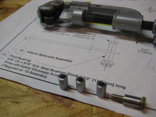

Brief Description:  Finished rear wing spar W12-01L
Finished rear wing spar W12-01L. That completes sheet W12.
Then made the 4 bushings needed for the two bellcrank assemblies on W21. I started trying to cut the steel bushings with the band saw, but that wasn't going very fast at all, and the metal was overheating. So I got out my pipe cutter, which usually cuts copper, but it did a fine job on the steel. The trick was to clamp the bushing stock, and then use very small turns of the pipe cutter handle, going around the piece 2 or 3 times before tightening it. Then a little work with the files, sandpaper, and a tapered reamer (just to get the burrs out of the inside of the bushings), and they were done.
I should be getting my Wicks wing hardware kit tomorrow, so I can then make the rest of the bellcrank assemblies.

Pipe cutter used to make 4 bushings in foreground.
