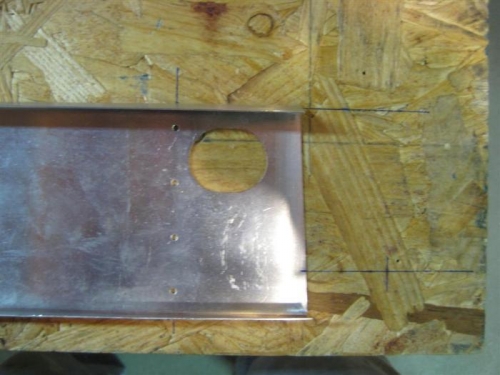

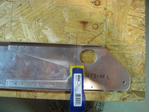

- As in the pictures below, I drew guidelines on my work bench, aligned the spar and then the W13-01L piece. I added a couple more clamps than shown in the 2nd photo, then drilled through right on top of the work bench. There are pilot holes that need to go through the W13-01 part, so I flipped the assembly over and drilled through using the pilot holes already in the wing spar.

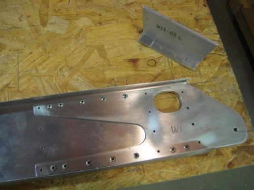

- Then I laid out the angle W13-02L, drilled 3/32" pilot holes, and aligned the shims. Next I need to drill through all the parts, including the shims.
Drew guidelines on my workbench, then aligned the spar with them
Used the guidelines to align W13-01L, and clamped in place for drilling
The root partially complete. Drilling the angle is next.
