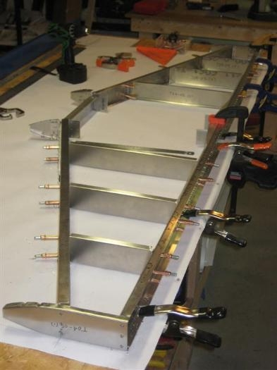

Continued with Horiz Stab
- Installed the tip ribs
- Squared up the spars by overlaying on a paper pattern created from the drawing measurements
- Installed the outer 3 ribs on each side of the stab (6 total)
- Next, need to debur and rivet
